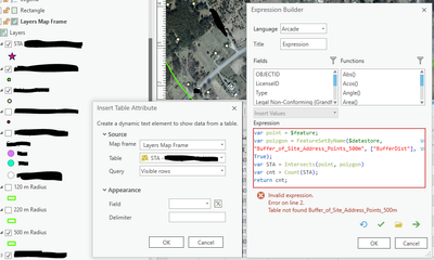

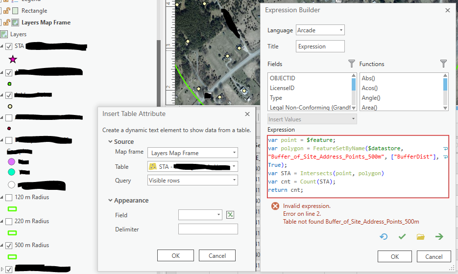

I would like to use dynamic text to display the number of points that fall within a polygon feature class in my ArcPro layout (*bonus points for an expression that only counts distinct ID values from my points layer*). Is this possible? This is what I have so far and keep getting an error:
var point = $feature;
var polygon = FeatureSetByName($datastore, "Buffer_of_Site_Address_Points_500m", ["BufferDist"], True);
var STA = Intersects(point, polygon)
var cnt = Count(STA);
return cnt;

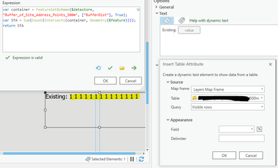

I think I'm getting close here. I have an expression that counts the number of points in a polygon BUT it currently displays as a list. Can someone let me know which expression I can use to Sum/Count the number of intersections so that my expression reads: "Existing: 14", rather than "Existing: 1 1 1 1 1 1.. "?
var container = FeatureSetByName($datastore, "Buffer_of_Site_Address_Points_500m", ["BufferDist"], True);
var STA = Sum(Count(Intersects(container, Geometry($feature))));
return STA
