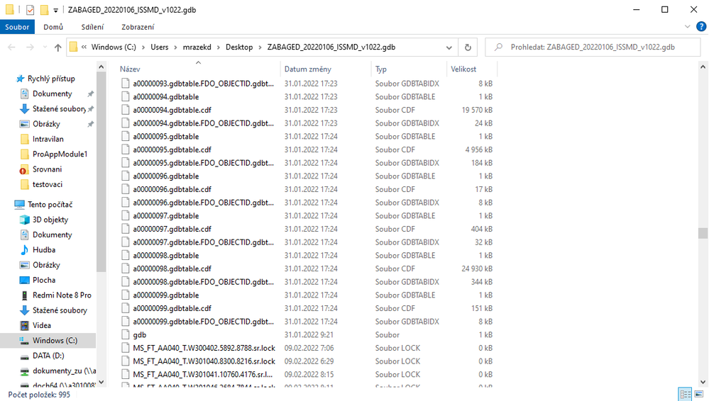

Hello,
I have a problem where I can't think of a way to copy certain layers to a new dataset. I thought I'd copy it as a normal folder, but it doesn't take the whole layer, which would then be executable in ArcGIS Pro.
Does anyone know of any way to do this?
Do I have to upload layers to ArcGIS Pro and then copy them?
Thank you for your reply.
David

IlkaIllers1
Where are these layers stored now?
I would use the tool "Feature Class to Geodatabase" which can import/copy it to a gdb or dataset from a shapefile or a gdb feature class.
I think it is the best practice to always copy/edit/delete data from within ArcGIS (for example the Catalog).

It the layers are in a geodatabase, make a gdb in the destination folder
Create a file geodatabase—ArcGIS Pro | Documentation then
Copy Features (Data Management)—ArcGIS Pro | Documentation
or
Feature Class To Feature Class (Conversion)—ArcGIS Pro | Documentation
and there are other options

Hello Dan,
How can I copy layers stored in FGDB?
