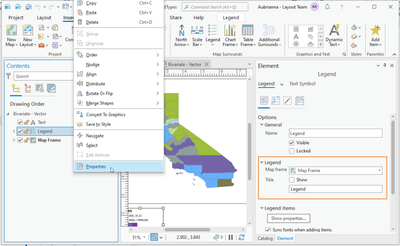

@AvaN I'm sorry this is giving you trouble, you should definitely be able to copy and paste between layouts! Can you look at the map frame being pointed to in your original legend and in the copy? It's possible something is getting messed up there even though they are the same map. To get this select the legend, right click, and choose properties to open the Element pane. Then look for the selected area I show below. If you could share some screenshots of that I'd be able to provide more info. Thanks for your patience and persistence!
Additionally, you can consider saving your legend to a style and then adding a new legend to your copied layout from that style, but you shouldn't need to. Copy and paste should work.
