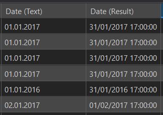

bhariadi
Hi @KenBuja ,
Thank you for your response, I also try your script:
if(IsEmpty($feature.DateText)) {
  return null
var date_split = Split($feature.datetext, ".")
return Date( date_split[2], date_split[1] - 1, date_split[0])
and give me this result:

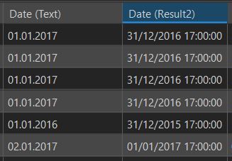

KenBuja
MVP Esteemed Contributor
You have to set the time zone for your layer since it defaults to GMT. Your time zone is seven hours off.
bhariadi
Hi @JohannesLindner ,
Thank you for your response. I have tried the arcade script & get this result.

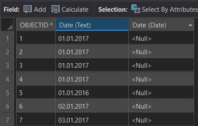

TimOrmsby
Hi, the Convert Time Field geoprocessing tool is another option.
bhariadi
Hi @TimOrmsby
Thank you for the solution. With this geoprocessing tool I don't need to run a script.
This is the result:
