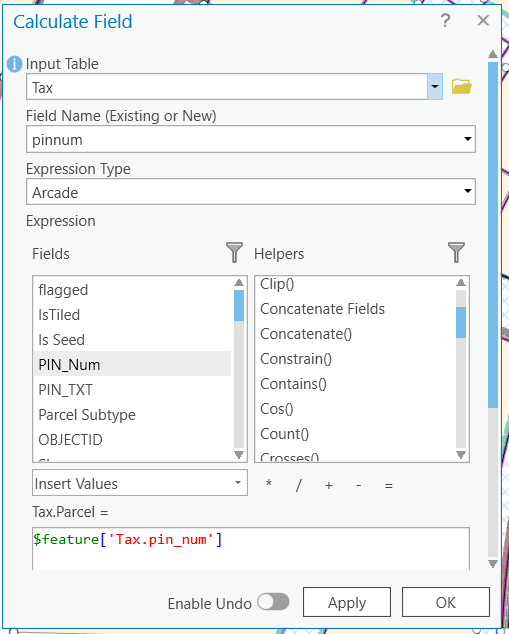

I am trying to do something that is probably simple, but in reviewing the Arcade functions, I didn't find the one that will do this.  I created a new field as an integer, and I now want to move contents of another field into it using calculate field.   The other field is a double field type (even though all should be whole numbers).

The error is telling you that you can't write the value "14000002735000" from a double field (storable range -2.2E308 to 1.8E308) to a long field that will only be able to hold values in the range from -2,147,483,648 to 2,147,483,647.

Matthew - yes, you can do this with a simple Field Calculation using Arcade.  In my graphic below, I have two fields Double (populated) and Integer (short integer type).  I right clicked on the Int field, selected Calculate Field, and calculated the Integer field using $featue.Double (these are just my field names is all).

OK.;  This is exactly what I was trying to do.  It must be something else going on.  Here are some screen shots:
What I am trying to do:
Table structure:
Error messages:

Thanks Xander.  I understand now, but I would then need to find a different way to handle the problem I was trying to solve.  For some reason when I am storing  50290115605026 in the double field, ArcGIS Pro is adding extra digits behind the decimal point.  See below:
How do I tell the database that I need to store only whole numbers that are larger than a "long" integer?
