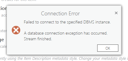

I am attempting to Connect to an instance of an enterprise database (SQL Server database), but I get the above error message in Pro, but the same connection works just fine in Desktop or Catalog.
I am using Operating system Authentication.  64-bit server, SQL Server 2012

I'm running into this issue. Was there a solution? Is it not possible to connect to a SQL Server 2012 SDE database?

Yeah, I would say that SQL 2012 is not supported on that version of Pro; https://enterprise.arcgis.com/en/system-requirements/latest/windows/database-requirements-sqlserver....
The "oldest" version of SQL Server supported is 2016. Even Pro 2.8.x does not support SQL 2012.
SQL Server 2012 is not supported by MS anymore: https://learn.microsoft.com/en-us/lifecycle/announcements/sql-server-2012-windows-server-2012-2012-r...
I would recommend moving to a more modern SQL Server version, like 2019 or 2022.

Thanks @George_Thompson , I'm looking at moving our database to another server. The one it is on now can't be updated due to other systems relying on it. Thanks for your help.
