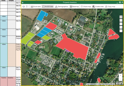

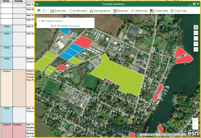

Have you tried to use ArcGIS Maps for Office? I've had some luck connecting an excel table to a feature layer on ArcGIS Online. You can add a map to the excel sheet to preview live changes and then overwrite your feature service from excel. You could then open the feature service in ArcGIS Pro to see the changes there.
I changed the Status field in my excel sheet from active to surplus, and you can see that the polygon colour changes from red to green in real time.
