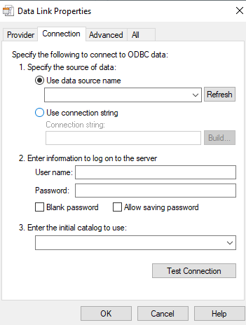

However in arcgis pro I can not see anything populated in here:

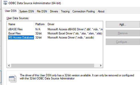

This might be something to do with 32-bit/64-bit ODBC drivers.
In the 64-bit ODBC admin it says access ODBC is only 32-bit.
I do configure it in the 32-bit admin, but it doesnt show in arcgis pro.
Any idea?
P.S. I can use arccatalog to connect to this same mdb file.

AyanPalit
@VaL Follow the steps below:
  1. Start ArcGIS Pro
  2. In the Catalog pane, right-click the Databases category and click New OLE DB Connection
  3. On the Provider tab, click Microsoft Office 12.0 Access Database Engine OLE DB Provider for the type of data you want to use.
  4. Click Next or click the Connection tab.
  5. Click Test Connection to validate that you entered the connection information correctly.
    On the Connection tab, provide the required connection information.
Reference: https://support.esri.com/en-us/knowledge-base/faq-is-it-possible-to-connect-to-a-microsoft-access-ac...
