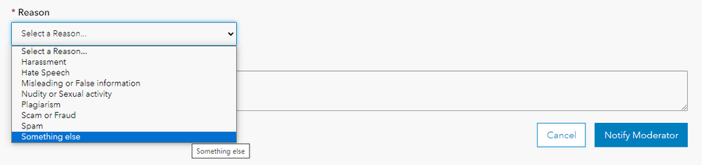

I think this would be better as an idea, not a questionhttps://community.esri.com/t5/arcgis-pro-ideas/idb-p/arcgis-pro-ideas
You can either create a new idea. Or ask a moderator to convert this question to an idea:
