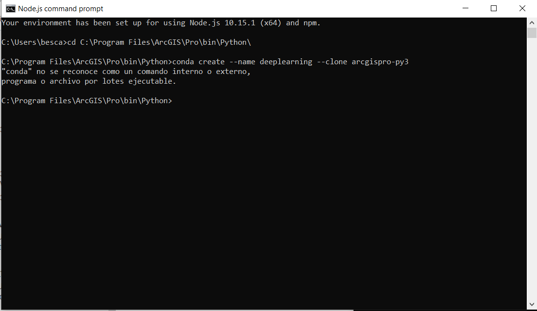

Hi, I am trying to install deep learning frameworks on my ArcGis Pro 2.5 and I get this message when I try to execute the first step to conduct the installation:
conda create --name deeplearning --clone arcgispro-py3
it basically says "conda" is not recognized as an internal or external command, program or executable batch file.
I don't understand what is going on. Please help!
