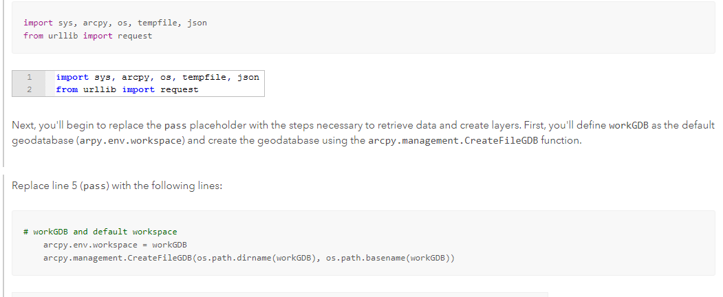

So .... import arcpy
fails?
If it fails, then you don't have it installed properly or are using a notebook that doesn't know where arcpy is.
Are you using arcgis pro's installation of jupyter notebooks? or a standalone jupyter notebook or jupyterab.
Thanks.I do the exercise using a spyder. How do I teach him where the package is?
