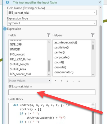

any idea why this code fails please ?

You don't seem to account for null at all but it is hard to read

Also, I see the python function, but don't see you calling it:
You need to call update() and pass the variables to it.

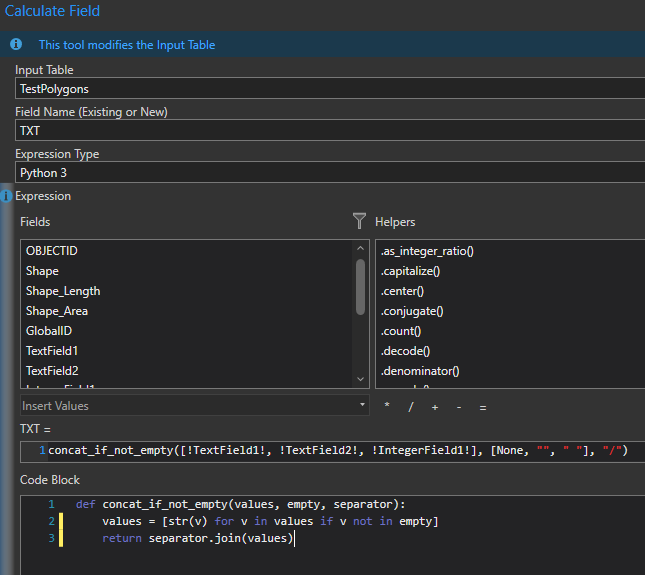

Like the others have said, you actually have to call the function, and you should compare to None, not space.
x = [1, None, 2]
for y in x:
    print(y is None)
# False
# True
# False
Also, your function is needlessly complicated. Just use something like this:
# BFS_concat_trial =
concat_if_not_empty([!Field1!, !Field2!, !Field3!, !Field4!, !Field5!, !Field6!], [None, "", " "], "/")
# code block
def concat_if_not_empty(values, empty, separator):
    """Concatenates non-empty values.
    values: list of values to concatenate
    empty: list of values considered empty
    separator: character used for concatenation
    values = [str(v) for v in values if v not in empty]
    return separator.join(values)
