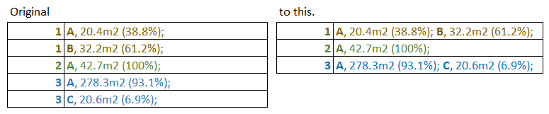

I'm trying to concatenate an attribute from multiple records by the record's ID.
For example: The two descriptions for 1, and again for 3, added together as one record. (see below)
Concatenating the information associated with common ID'sConcatenating the information associated with common ID's
My dataset has over 2500 records.
I've tried using the Pivot tool, and I managed to get the ID numbers merged with their corresponding descriptions. but the descriptions were spread over 2500 fields. Way too many to concatenate.
I'm sure I've seen this demonstrated in an Analysis MOOC, but I can't find it. 😞
Any help or ideas welcome.

I agree with @JoeBorgione that Python is really your best option, maybe your only option until Esri updates the Summary Statistics tool to include text concatenation.
Below is some code that should work for you in the interactive Python window, after you make the appropriate changes to tables and field names (make sure to backup table first!):
import arcpy
from collections import defaultdict
lyr = # name of layer in Pro map
flds = ["ID_FLD", "TXT_FLD"]
sql_orderby = "ORDER BY ID_FLD, TXT_FLD"
cat_txt = defaultdict(str)
with arcpy.da.UpdateCursor(lyr, flds, sql_clause=(None, sql_orderby)) as cur:
    id_prev, txt = next(cur)
    cat_txt[id_prev] = txt
    for id, txt in cur:
        if id == id_prev:
            cat_txt[id] += " " + txt
        else:
            cat_txt[id] = txt
        id_prev = id
    cur.reset()
    cur.updateRow([id_prev, cat_txt[id_prev]])
    for id, txt in cur:
        if id == id_prev:
            cur.deleteRow()
        else:
            cur.updateRow([id, cat_txt[id]])
        id_prev = id
