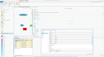

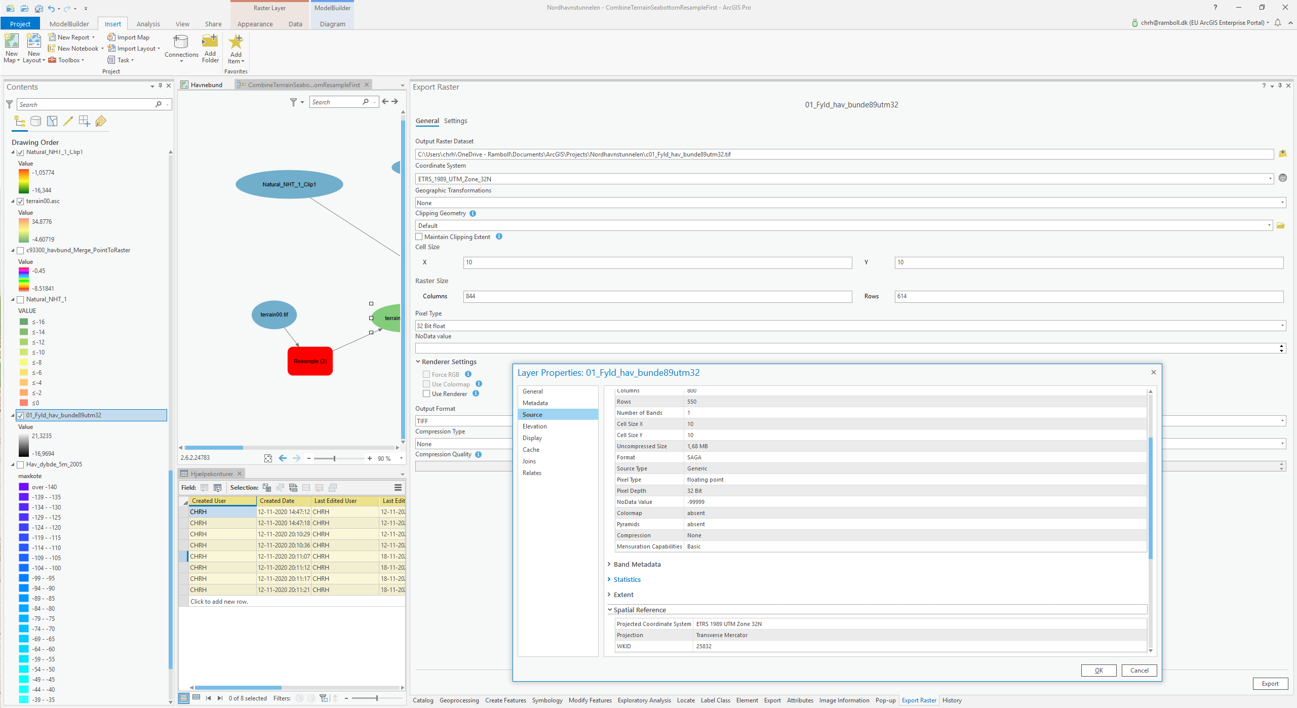

I am using ArcGIS Pro 2.6.2 and I am having issues using the export raster function since it insists on changing my dimensions. the raster is recognized as 800x550 and 10m cells, but insist on saving it as 844x614 10m cells. I am using the same output projection as is already defined for the raster.
Is this a bug or am I missing something?
Also it is quite weird that .asc files no longer appears in the filewindow along with other rasters but you can drag and drop the files to the maps to load them.
ChristianHaugwitz
I found that changing the projection of the current map to the output projection fixed the problem.
My data input is a mix of data in DKTM3 and UTM32 ETRS89, so the map was in DKTM3 and I was trying to save to UTM32 ETRS89 and have chosen that as my output projection.
