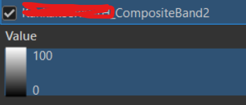

so, i have two rasters, one is a categorical (say 1) that has values from 0-100, and the other is a continuous (say 2) DEM.
The desired band order is 2 and 1

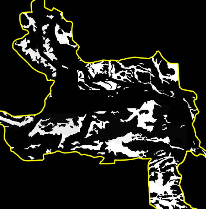

When i run the Composite Bands tool and use the order 1 and 2 for the input rasters i get this output

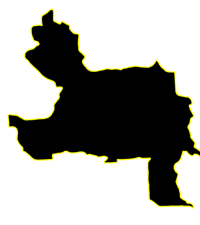

When i run the Composite Bands tool and use the order 2 and 1 for the input rasters i get this output
Why is the band order 2 and 1 output so different and is not showing any values?
ps ArcGIS Pro 3.4.3 is being used

without seeing your legend, I suspect you are just seeing the band that is on top.  You won't "see" through all bands.  My point was about combining rasters, not what they look like.
