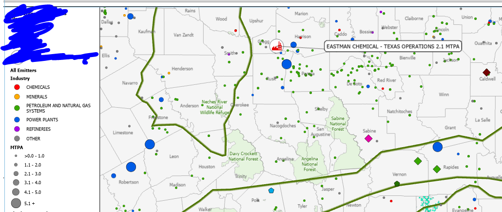

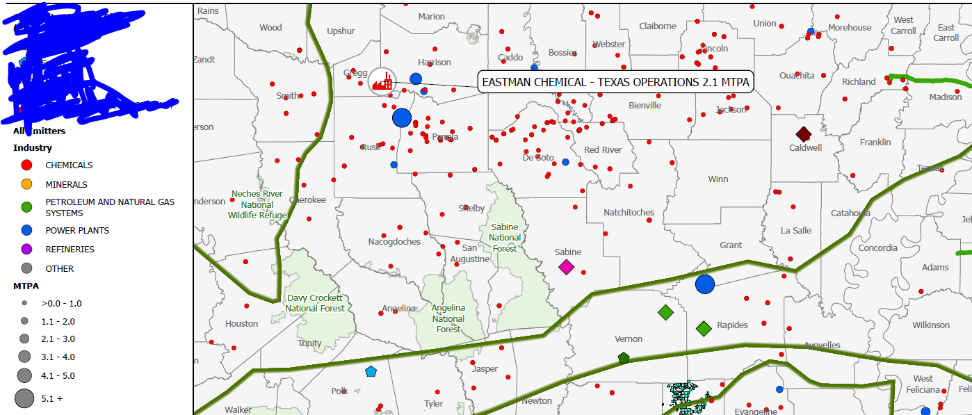

I have a point layer that I am symbolized by graduated symbols. I am also varying colors by another index field. when I view the map in the layout view, everything looks great. When I export the map to pdf, the varied colors change somewhat randomly. The work around is to use .png or .tiff, but I prefer .pdf and it is perplexing why this happens in the first place.
This is the Layout View
This is the .pdf.

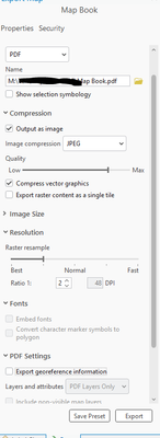

I found that when you export to PDF, you need to check the "Output as image" under Compression to keep all colors.
