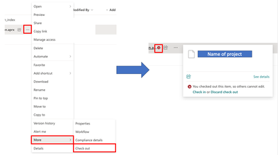

It might be useful to have the team members "check out" the project file. On Sharepoint, if you right-click (or click on the 3 dots) and go to "More" there is a "Check Out" option. This will then put a symbol on it and prevent others from editing it until it is checked back in. I haven't used it for project files but have used it for managing access to Access databases successfully.
