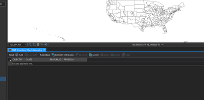

Please help me how to check the multipart to single-part. I checked with check geometry. I got "could not find spatial index at -1" Then I used "add spatial index". Then again checked Geometry.
 Still If I use clip raster and check the box of " use clipping geometry" The process is  getting freeze at some polygons.

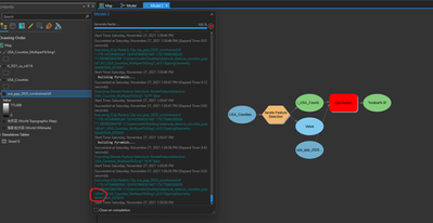

clip rater is successful when I do it only that one polygon(69.tif)
But using the model builder it's getting stuck at "69.tif" as shown in the above screenshot.
