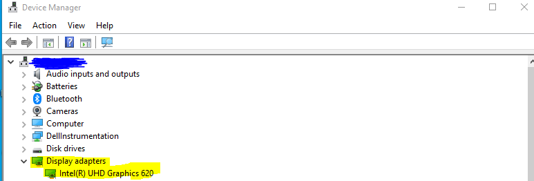

After going through the details I suspect that there are two graphic card one internal (Radeon Graphics) and one dedicated (NVIDIA) . Can you confirm that by going into device manager by clicking on start icon and searching for device manager.
In the device manager window expand display adapters and check if more than 1 item is listed.
Attaching a screenshot for your reference.
If there are two items can you try disabling one and work with ArcGIS Pro and see if the issue persists. Conflict between graphic cards can cause this issue. I would suggest you work with your IT while performing the above mentioned troubleshooting step.

@AngelBarnett  Thank you for sharing the details.

@wizgis You are correct, there were two active display adapters!
I disabled the internal Radeon Graphics card and so far I have not experienced any issues with the contents pane or the application crashing.
I haven't used ArcGIS Pro enough to be sure this fixed the issue, but fingers crossed things will continue running smoothly.
