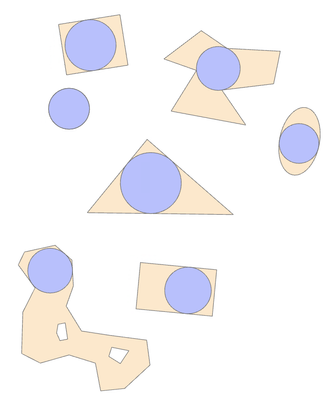

For any given polygon in a feature class I would like to create the largest possible circle that fits within this polygon (see examples below); in case of the original polygon being a circle, the new circle would be identical to the original.
Is there a function in ArcGIS Pro to achieve this?
