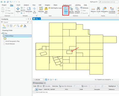

I have a shapefile that has overlapping polygons. I've used the Select tool to try to select all the polygons at a specific location -- at the red dot in the screenshot below:

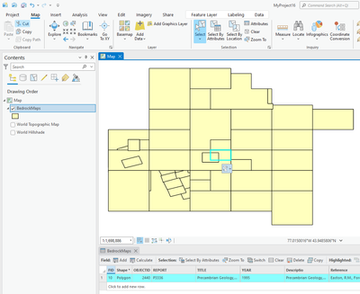

I've single-clicked at that location, which has selected a single polygon:
It seems like ArcGIS Pro is behaving differently than ArcMap did.
  • ArcGIS Pro selects just a single polygon, even if there are multiple overlapping polygons at that location.
    • Note: I'm aware that using a different selection technique, such as select-by-rectangle, behaves differently: all overlapping polygons get selected. But that's not the focus of this question; the focus is single-click selections.
  • Whereas ArcMap would have selected all of the polygons at that location when doing a single-click selection:
As a new ArcGIS Pro user, that difference in selection behavior threw me off a bit. I didn't understand why all the polygons at that location weren't being selected.
Further, I would have thought that the top-most polygon would have been the one that got selected. But it doesn't seem to work that way; a polygon that is lower in the stack has been selected.
Question:
What logic is used for single-click selections when there are multiple overlapping features? How does ArcGIS Pro determine what single feature to select?
