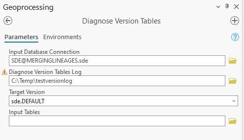

Okay - I think I see what's happening in your screen shot.  You're missing the Target Version parameter.  See attached below for my GP tool.  It worked as expected.
