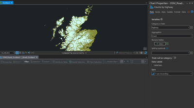

I am a beginner and I would like to create a chart to count the number of road types in 'OSM_Roads_Scotland'. But it doesn't show up.
The source of the data is: ArcgisPro Tutorial quick  started tuorial author a map
I've also tried using other data to create the chart and it still won't display.

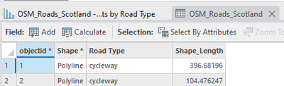

Attribute Table Data

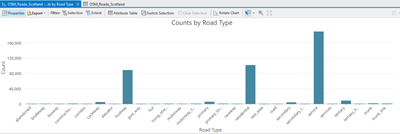

There is no field named highway but Road Type instead:
Chart creation worked OK.

tianboyue
Thanks for the answer,problem solved!
