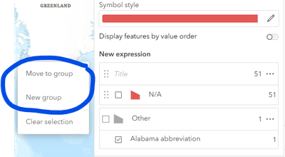

Edit: I just tried a similar thing with some Living Atlas data, and I think #3 might be the problem:
  1. If you make the conditions not overlap, does it work then (I don't think this should matter, as the documentation says When "Evaluates a series of conditional expressions until one evaluates to true")?
  2. Have you double-checked that the data does have the combination for "Edited"?
  3. Another thing to check is that "Edited" isn't somehow being grouped into the "Other" category (see if "Other" has a number next to it indicating how many features are in that category).
To get symbology from "Other" into a new group, check the box next to it and choose "move to group" or "new group":

Thank you for the reply. I see what you are saying about a when statement evaluating until it finds a True statement. I did not have any Edited = Y values in my data. I was planning for the future. I had to temporarily make the condition true for the symbology to show up.
#3 in your answer was also helpful. When I did make the condition true, it was grouped into Other and had to move it out of the group.
