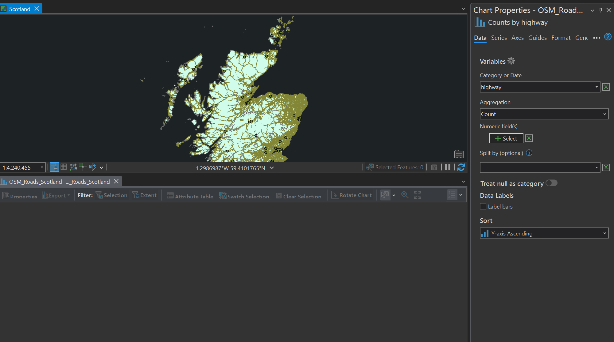

Hi all,
I am a beginner and I would like to create a chart to count the number of road types in 'OSM_Roads_Scotland'. But it doesn't show up.
The source of the data is: ArcgisPro Tutorial quick  started tuorial author a map
I've also tried using other data to create the chart and it still won't display.

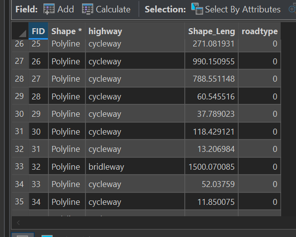

Attribute Table Data
I’m not sure what I might be missing, and I’d appreciate any help or suggestions!

BarryNorthey
Be sure to use Author a map v310 or later to suit your software version.
There is no field named highway but Road Type instead:
Chart creation worked OK.

tianboyue
Thanks for the answer,problem solved!

Hi @tianboyue ,
Thanks for reaching out and sorry you're seeing this issue.
I wasn't able to reproduce on 3.3.2, so here are a few questions:
  • Does the chart display any message on the chart window, or is it completely blank? (It appears to be completely blank but just checking...)
  • Have you tried creating any other chart types (eg histogram, scatter plot, etc)? Did they work?
  • Have you tried restarting Pro and attempting to create the same chart?
  • Have you tried a different project?
