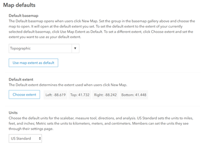

If this is just a one-off, just tweak the layout. If you're looking to permanently change the default extent, you'll need to adjust the organization settings.
Go to your-portal-url/home/organization.html?tab=map#settings.
In the map defaults section, you can change the default extent. Once changed, any newly-created map in the web or in Pro will open on that extent.
