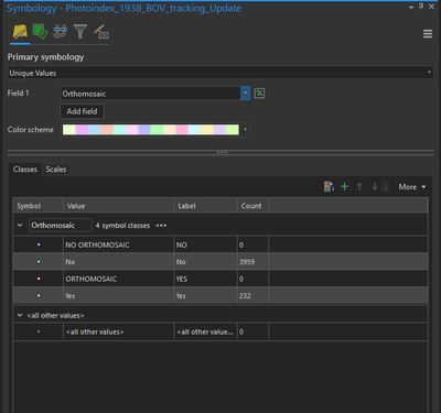

Well, I have been struggling with this Domains, because I work on to try and decide what to put the Domains and Whenever I delete or add. It does not update.  It also show some kind of werid is that the Domains does not delete at all.
In the Symbology, I always go there and change each field. Some look ok. Some look really stange..
I delete No and Yes in the Domains and then add No Orthomosaic and Orthomosaic. Does not update at all...
Even though, I delete the 4 symbol classes and then add

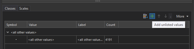

And then I clicked on Add unlisted values

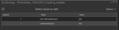

This above screen should be show up on the Symbology when you immediatly change to Orthomosaic field.  and it only shows 4 classes.
It doesn't remove at all...

So I got my problem solved.  Use by "Select by Attributes" in the Map Tab and then use the SQL query to fix the problem.
