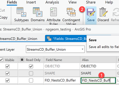

The approach I have always used is
  1. open fields view
  2. change the alias
  3. select Save
  4. switch back from fields view
and the alias sticks if I set my table to use aliases.
If this is not the procedure that you normally use, or it doesn't work for you, then I would open a case with tech support

In the Fields Designer at the very top of the pane, for current layer, click the dropdown and choose Data Source.  As long as the new field does not have any data in it you can change the Field Name and Alias.  Make the changes and then click Save on the Fields contextual tab.  This will then change the schema of the feature class so the next time you add it to a new map view, your changes are "remembered."

I was having this issue and resolved it by editing the fields directly within the .gdb. So, in the catalog, right click the feature class within the gdg, go to "Data Design --> Fields" and edit from there and save edits using the Fields tab, like DanPatterson mentioned earlier in the thread. Hope this works for ya'll as well.
