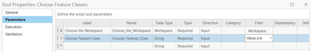

I think you may have a parameter which allows you to select feature layers from the Contents pane?
3: Change this parameter using the following as a guide:
Label:                  Choose the Feature class
Data Type:          String
Filter:                   Value List            (This means your parameter will display values within a drop down list)
Your parameters tab in the Tool Properties dialog  box should look like the following:
Notice the numbers next to the parameters: 0 is the position of the workspace parameter while 1 is the position of the feature class parameter. You will use these numbers in a moment.

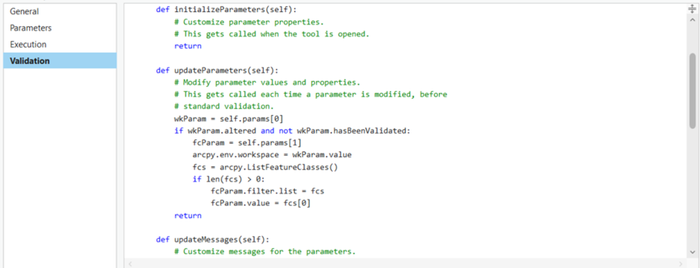

5: Locate the updateParameters() method.
6: Underneath the comment for the method write the following code:
wkParam = self.params[0]
if wkParam.altered and not wkParam.hasBeenValidated:
    fcParam = self.params[1]
    arcpy.env.workspace = wkParam.value
    fcs = arcpy.ListFeatureClasses()
    if len(fcs) > 0:
        fcParam.filter.list = fcs
        fcParam.value = fcs[0]
Be aware of the importance of indentation!
What the code does is:
  • Get the parameters from a list of parameters from the dialog.
  • Check to see if the workspace parameter has been altered by the user choosing a workspace and that the parameter has not gone through ArcGIS Pro’s validation routines already. If you don’t put this check in then you will be forever in a validation spiral which will affect the performance of your script tool.
  • Get the chosen workspace and a list of feature classes
  • Assign the list of feature classes to the feature class parameter using the filter and list properties on the Parameter object. Remember we set the Filter to be a Value List earlier?
  • Get the 1st item from the list and assign it as the first item for display in the combo box before the user clicks on it.
The method should look like the following:

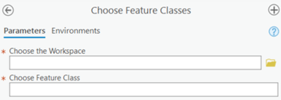

8: Double click the script tool to display the dialog:
9: Choose a file geodatabase
The Choose Feature Class parameter will now be populated with the feature classes within the chosen file geodatabase.
If you choose a different file geodatabase then the drop down combo box will be cleared and re-populated with the new feature classes from the geodatabase!
