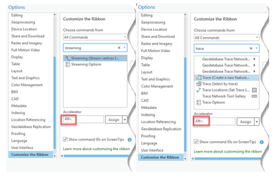

I would suggest setting up custom accelerators for those construction tools. See: https://pro.arcgis.com/en/pro-app/latest/get-started/customize-the-ribbon.htm#ESRI_SECTION1_0B9AD340...
Accelerators usually need to be a combination of keys, for example, I'm using Alt+, and Alt+. in the screenshots below (Alt + comma and Alt + period). Streaming already has a built in keyboard shortcut and that's F8, but if you're switching between streaming and tracing a lot, it might make sense to make the accelerators close to each other on the keyboard.

Thanks, this is what I was searching for
