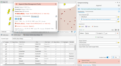

I want to transfer a row or rows to another attribute table. I know that I should use the join command, but the problem is that when I run the command, the error message Target *** is read-only appears. On the other hand, I cannot find the attribute table to change it from read-only mode. How do you think I can solve this problem?

MAHDISaeediNik
Thank you for your reply.
But unfortunately, despite unchecking the "read only" modeScreenshot 2024-03-04 232842.png, the error message is repeated.

is your table being pulled in from a  feature service?
MAHDISaeediNik
Yes. A KML file has been converted into a Layer. Is this important for future operations on the "attribute tables"?
