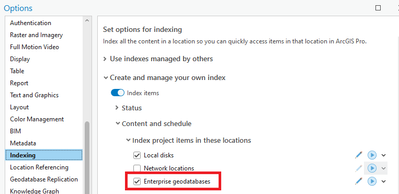

Hello @Daniel4  @AdrianWelsh , The Search Project function will only search items that are Indexed, and by default, Enterprise Geodatabases are not Indexed. However you can turn Indexing on from Project > Options > Indexing, then you should be able to use Search Project to look for Geodatabase content.
