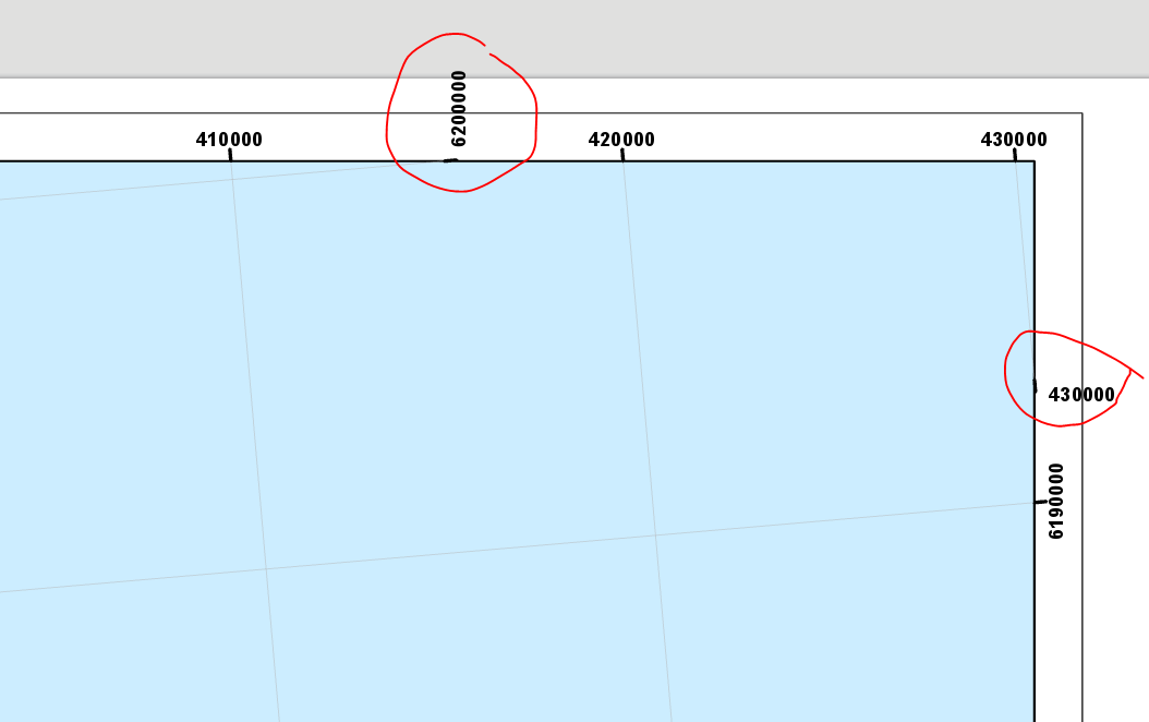

Hi,
I am trying to create a map series following a linear feature, with each page rotating to a set value.
This has worked fine, however previously in Arcmap I would have all of the grid labels on the X axis oriented horizontally and those on the Y axis oriented Vertically (to maximize space for the data frame).
In ArcGIS Pro this option seems to be related to whether the label is on an E,W,N or S grid line , rather than top,bottom,left or right axis ... and as such seems to be producing odd results, that I cannot rectify:
Ideally, as in ArcMap, i would want these labeled to automatically be oriented in line with the frame border ... not the same as the other labels of the same oriented grid-lines.
I don't think that coverting to graphics is an option as I assume this will not work with a map series.
If anyone has any ideas on this, they would be greatly appreciated !
Loz.
