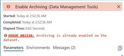

I have been using branch versioning in ArcGIS Pro where my enterprise  geodatabase platform is PGSQL. When I registered the featureclass as versioned, the option to archive the featureclass gets greyed out(obvious due to the fact that archiving is natively available in branchversioning) . The dataset has been registered as versioned without option of moving edits to base and I am still unable to enable archivingon my dataset. I need to have GDB_TO_DATE field so that I can perform the moment queries as explained here.

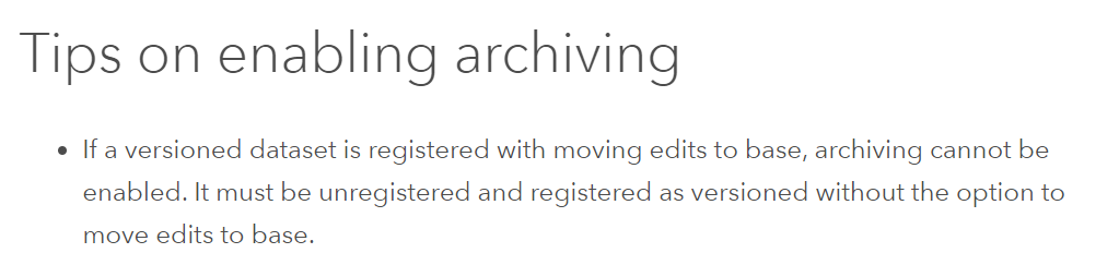

As per below tip, I am registering the dataset without an option to move edits to base

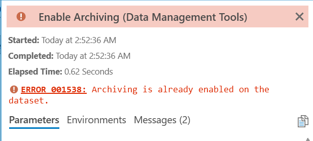

When I try to enable archiving, I get following error message which says that the dataset is already archived but if it is so then why I do not see GDB_TO_DATE field in the archive featureclass?
