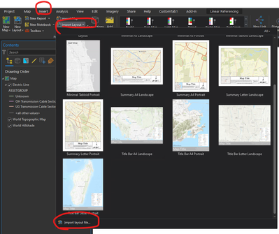

GeeteshSingh07
@DavidGray1 once you have created a layout in ArcGIS Pro, you can save it as a "Layer File" (.pagx). This saved file can be used as a template.
How to save as Layer File?
Open the Layout, click on Share tab in the ribbon.
Click Layout File:
Save the file. The template is created!
How will I use this layout template?
Click on Insert tab, click Import Layout >> Click Import layout File:
How to check Esri's Layout templates that are provided with ArcGIS Pro?
Click on Project tab on top >> click Options >> Layout
Here, you have "Import Gallery Path" where all Esri's provided Layout template are stored.
For more details, you can check this out:
https://support.esri.com/en-us/knowledge-base/how-to-create-a-layout-template-from-a-layout-for-diff...
Hope this helps. 🙂
