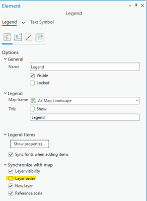

Hi there, appreciate that this is quite an old thread now, however I had the same problem today where I couldn't rearrange legend items.  The solution in this case was to turn this setting OFF from within the legend properties.
Hope that might help someone who stumbles across this in search of a fix.
Credit goes to my colleague who had to help me find that setting!

Thank you @Cavaletta , i had the same issue today and unticking the "New Layer" in "Synchronise with map" menu helped 🙂
