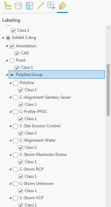

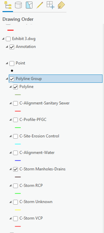

I want to set the labels for every layer in a group at one time. Set the field, the color, the font, the size etc.
Here's the labeling tab in TOC:
Here's the Drawing order tab in TOC:

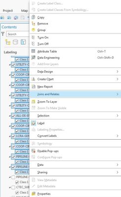

@RhettZufelt that was it! Exactly what I was looking for! I didn't know it could be done. Hidden features. Thank you!!
Note to others - don't make the first mistake I made by right clicking on the Layer Name in your selected list, you won't get the right menu:
 You have to right click on the label class name.
