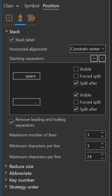

Check your label settings. It may have "stack" enabled, which will insert line breaks on spaces and commas as the program deems necessary to fit everything in. Unchecking the box lets you define the label lines as you need.

That was it. Stack Label was enabled. Thank You!
