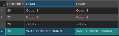

I am trying to write an Attribute Rule that calculates the value in FieldA over to the value in FieldB. Both fields have the same Domain applied (domain named "TwoOptions"), and that Domain has two codes: {OPT1: Option1, OPT2: Option2}.
Here is the Field View, followed by the Domain.

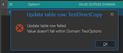

The problem arises if I try to manually change FieldA back to a valid value. I get the following error. Hitting "OK" reverts FieldA's value back to "VALUE OUTSIDE DOMAIN".
Seems like FieldB is being validated for allowable domain values BEFORE the newly updated valid value from FieldA is calculated over to FieldB. Am I missing an order-of-calculations thing here? Something else?

It appears the fix for this was simply checking "Exclude From Client Evaluation" box within the Attribute Rules interface for this particular rule.
I still need to read through the post here (entitled Attribute Rules - Exclude from Application Evaluation) to fully understand why that is though.
