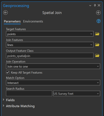

Hi Daniella,
I would do a spatial join of the points to the lines, which will give you a field called "Join_Count" that will tell you how many lines the point intersects with. Then you can just do a regular selection based on that attribute.

A quick clarification or two for both @GTueller and @DaniellaRose, because I can't remember and don't have a chance to test right this second:
  1. Is the intent to find points that intersect with at least 3 line endpoints, or 3 lines anywhere along their length?
  2. Spatial Join: Intersect will return the latter.  Would any of the Match Options in Spatial Join return the former?  Possibly "Boundary Touches"?
