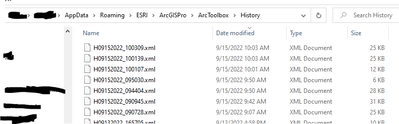

Greetings All,
I'm doing a clean-out of my drive and noticed I have over 5GB of XML files in the following folder:
Can I delete these without hurting anything? Should I delete through the File Explorer or can I do so through Arc Pro?

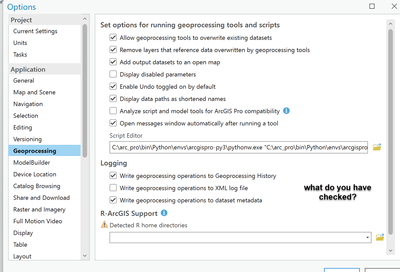

Analysis tab, left most tool on 2nd row... aka History.... click it.
Select and delete all that you don't want.
Check your options in Project, Options

Hi @DanPatterson, Thanks for quick reply.
Referring to your Options screenshot, I confirmed that the "log to XML" box is un-checked.
Based on a test, the XML files appear to get created when I run a python script that uses arcpy outside of Pro, e.g., when I run through VSCode or some similar interpreter. Specifically, when I ran a script via VSCode, it made a new XML file, but when I ran the same script via a Pro toolbox, it didn' t create an XML file.
So it seems like running arcpy script outside of Pro creates the XML file? I wonder if there's some env parameter you can set in the script to prevent creation of XML files?
