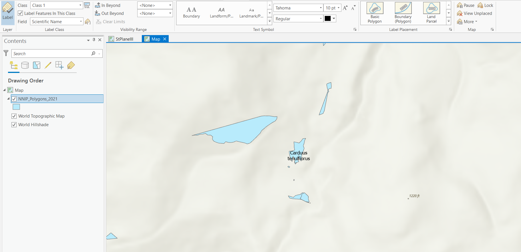

I am working in Pro with a polygon feature class that was exported as a file geodatabase from ArcGIS Online.  When I try to set up labels for it, only one feature shows the label regardless of which field I choose. I've also exported the feature as a shapefile, as well as tried it with ArcMap, but the same problem occurs.
I've tried resetting the labeling properties, using both Maplex and Standard settings.
I am able to label the original layer in ArcGIS Online successfully, so it is just this particular exported feature class that is having the problem. I exported different layers from AGOL as FGDBs and have been able to label all features successfully.
Hopefully it is something simple that I'm missing, so I'm hoping someone can point it out to me!
Thanks!

Is it possible that the other labels aren't showing because either a query is added to the labelling class, "Class 1" that only corresponds to that one feature being labeled, or that the other labelling classes don't have the "Label features in this class" option checked off?
Hopefully it's simply that!
KerryWilcox
Thanks for your suggestion, Vince.  There is no query added to Class 1, and there are no other label classes.
I just tried re-uploading the GDB to AGOL, and had no problem labeling all the polygons there, so I'm still stumped.
