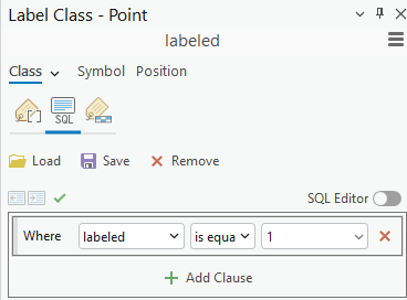

JesseWickizer
There's not a direct way limit the labels in a layer to only selected features, but here are a few workflows to consider.
1. Convert features to annotation or graphics. These tools convert only the selected features to annotation or graphics.
2. Create a selection layer from the selected features and turn on labeling for that layer only. When the layer has a selection, right-click the layer > Selection > Make Layer From Selected Features. This layer doesn't dynamically update as the selection changes so you'd have to make a new selection layer to label a different set of selected features
3. Add a "labeled" attribute to the feature class to define which features are labeled. Configure a SQL query on the label class to only include those whose "labeled" field equals 1 (or however you want to define it).
When you make a selection, update the "labeled" field for the selected features and they will be included in this label class.
You could create a model that does the following 3 operations so every time you want to label a different set of features, just double-click the model and it will update the dataset so only the selected features have the '1' value in the 'labeled' field.
  • Calculate Field (field name = labeled, expression = 1)
  • Select Layer By Attribute (Selection Type = Switch the current selection)
  • Calculate Field (field name = labeled, expression = 0)
