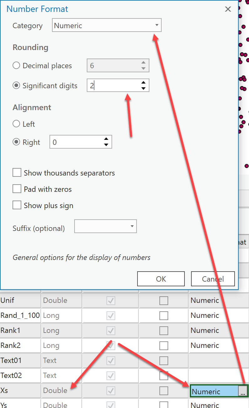

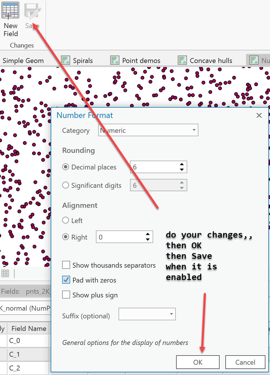

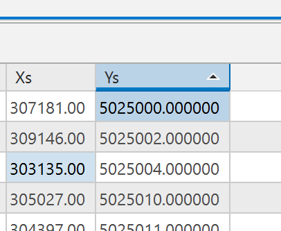

I set one to 2 and 6 decimals
Bring up Fields view, and click Numeric format
Do the stuff to make it look like you want Then press OK, the don't forget to Save

I set the decimal places to 2 and left the significant digits at 6 and then made the field calculation and that worked. But, it changed  the significant values to 2 automagically.  Not sure what's up with that, but there's a lot about Pro that I'm not sure about....
