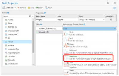

  1. Add Spatial join, configure as needed
  2. Remove any unwanted fields via Field Map
  3. In the Field Map, Edit Fields (click the pencil next to a field) where you want the highest value to be preserved and set the action to MAX

Hey @FlightDeck, thought about a few different options here..
I think testing spatial join will be a good starting point to see if this deliveries what you require.
