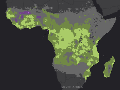

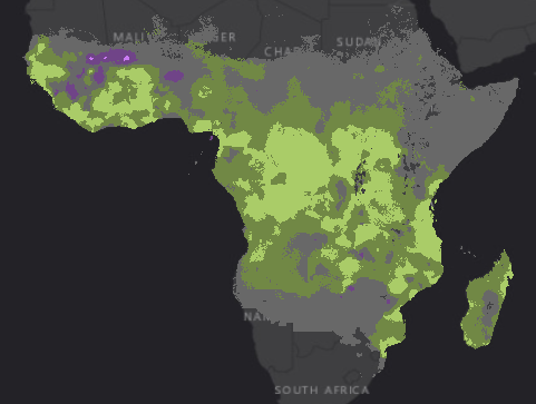

Hello there, I'm working on a project where I want to find the area on a map where Malaria rates did not decrease. I can't calculate the area with an attribute table because my map is a continuous dataset.
I'm trying to run CON to find only those areas that meet the criteria vs those that did not, but I don't know how to run the script (I'm a noob on this). I'm attaching two screenshots, basically, I want to calculate the area on my map ONLY where my values are equal and greater than 0.1. I would appreciate your help A LOT
