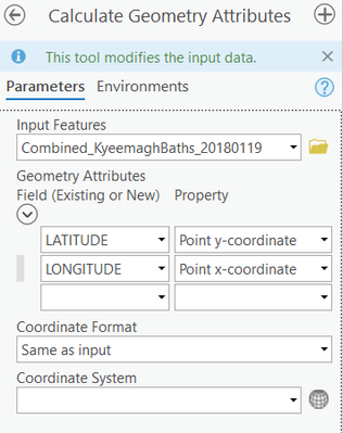

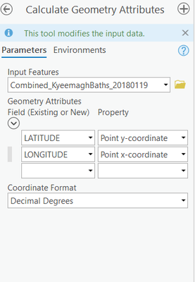

Yeah, that's what I thought! But the option to specify a geographic coordinate system (using GDA2020) disappears when I change the Coordinate Format to DD.
Before selecting a coordinate format:
When I've selected DD as the coordinate format (does the same thing for all other format options, aside from Same as input):

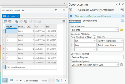

Here is an example.
The data are in a projected coordinate system and I want long/lat in decimal degrees in a geographic coordinate system.
If your data are already in a geographic coordinate system and your map is in a projected coordinate system, then you have to specify the coordinate system.
To make things cleaner, open a new map without any basemap or pre-set coordinate system.
Add just that one layer... Check its properties.  What is the coordinate system?
The map should be set to the coordinate system of the first added layer.  Check it.
Run the tool.  What do you get now?

Same thing happens, where the coordinate system dialogue box disappears, and setting the output coordinate system in the Environments tab doesn't make a difference.
