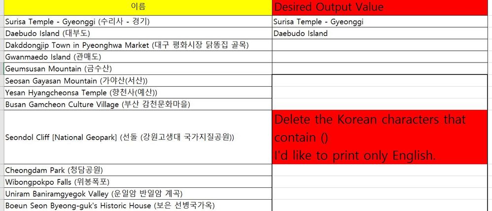

KalSsin
Hi~~~
!Name!.split('(')[0]
Name = Name.split('(')[0]
What should I do?
Thank you in advance.
