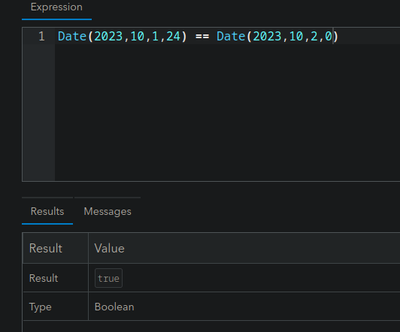

Ah, yeah. I didn't think about that. But if you put "24" into the hour parameter of the Date function, it automatically gives you midnight of the following day. Isn't that what you want?
Your particular error is because "=" is for assigning variables. Checking values for a conditional statement uses "==".

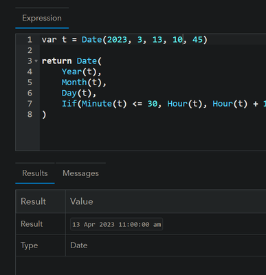

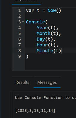

For Arcade, there are a bunch of datetime functions already built in.
For a given timestamp, you can use Year(), Month(), Day(), Hour(), and Minute() functions to get each respective piece.
Using these values with the Date function, you can recreate the timestamp and simply adjust the hour value based on the value returned by Minute.

Here's the value run at 11:18 today.
And here it is running for 10:45. Both evaluate to 11:00!
