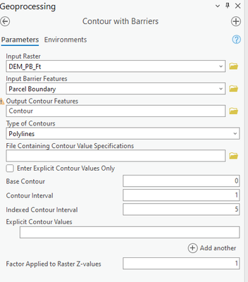

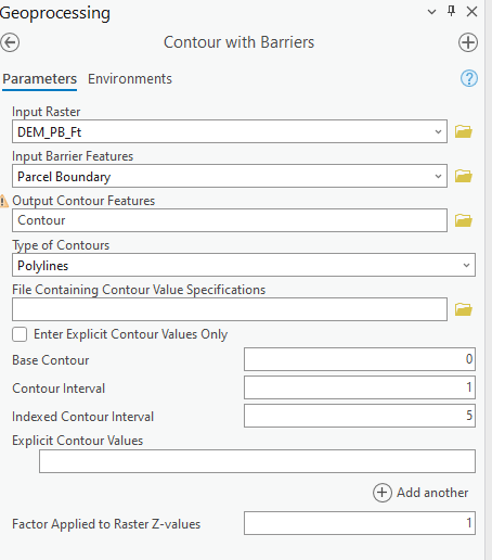

Hello,
I'm attempting to have elevation contours (in black) be visible only within the extent of the parcel boundary (in red).
Here are my input values using "Contour with Barriers":
I also set the extent to "Parcel Boundary" so that I'd only have contour data visible within the PB. However, I'm still seeing contours outside of the PB.
I'm sure its just a small detail I've failed to catch, so any guidance as to how to resolve this would be greatly appreciated.
Thank you.
SteveLynch
ContourWithBarriers will draw contours on either side of the barrier. You may want to use the Contour tool and set the processing extent in the Environment = Parcel Boundary
